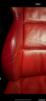

Another small job done today … doing my best to make the drivers side bolster a bit more respectable . I’m pretty chuffed with how it turned out . It’s not perfect by any means but a lot better than it was !!

Lucky for you your bolster repair skills are way better than your photography skills
Good job done
Good job done

Yeah I can’t seem to upload good quality images…

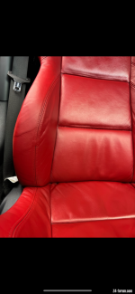

That better quality?

That's loads better!
That bolster has improved lots!
Did you use furniture clinic or similar for the paint?

It was scratch doctor , I did look at furniture clinic but their kit was around £150 !! … I paid £35. Used a leather filler and all in one dye from them . I have subsequently coloured the whole seat and the passages , as the red was ever so slightly lighter . Makes it look worse in the pic but easily had enough to do both seat . I’ll also put a couple fresh coats over the door panels , so it’s ok matched .
