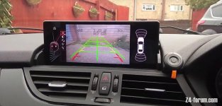

If you don't have OE iDrive then there is the option of an Android touchscreen. This installs in the space that is currently occupied by the dash top cubby, ie: as in the attached photo (shown with optional reversing camera). This will give you access to built-in apps for music, video, navigation and others as well as Apple CarPlay and Android Auto. Depending on supplier just make sure that if you don't have OE iDrive then you'll need the copy iDrive controller (you can install one of these screens in place of the flip-up iDrive screen to add onto your existing iDrive features if you do have it, where you wouldn't then require the copy controller). Also check on the available operating system version and RAM available.
