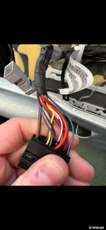

Part two of Ians E89 seats
What have we done so far:
With the help of Rob
Usel
we have swapped Ians non motorised M Sport seat cushions onto motorised bases. The car is a facelift and the motorised seat bases are pre-facelift.
The swap has gone well- we have put the seats back in the car. Plugged in and no airbag lights etc, heated seats work ok.
HOWEVER-
There is no electric seat movement in any direction. Initially I thought I needed to send power to them as in E85 world where I would run in a + and - to feed the seat motors, but Rob thinks the power to the seats is 'universal' and if its getting to the heating elements then its not a power issue- but a CODING issue
So- do I need to look at coding the seats into the car? If so- how?
Stuart

Rob and I have been conversing
We think that the passenger seat (pic attached) does just need + and - 12v from the distribution panel to the red/brown bigger wire
EWS Delete PM me
Coding- airbags etc PM me
bigwinn
Posts: 4689
Joined: Wed Jul 08, 2020 7:13 pm
Location: Lincoln UK
E89 Seats- help please
Post by bigwinn » Sun Feb 18, 2024 4:48 pm
However as the drivers wiring is much less obvious (again see pic) we think it’s GOT power but needs power on a switched basis via an FRM01 to the yellow/green wire
EWS Delete PM me

Post by AnubisZed » Sun Feb 18, 2024 5:03 pm
Wiring diagrams for both seats here...
https://www.dropbox.com/scl/fo/bsrdniyj ... qvhd6&dl=0
And you will need to code 459 to the CAS and NFRM fopr the memory functions to work :thumbsup:
Dave

Post by bigwinn » Sun Feb 18, 2024 5:15 pm
AnubisZed wrote: Sun Feb 18, 2024 5:03 pm Wiring diagrams for both seats here...
Thanks Dave
Any guides how to do the coding at all as that’s new to me? Think I have most software?

Post by bigwinn » Sun Feb 18, 2024 5:16 pm
And before I start wiring in power- is it the coding that’s stopping it working at present?

Post by AnubisZed » Sun Feb 18, 2024 6:11 pm
bigwinn wrote: Sun Feb 18, 2024 5:15 pm
Thanks Dave
Here's a link to one of my videos. Follow this process, instead of putting the codes shown into the VO you'll need to input 459. Once you've got to the 30 minute point in the video (where I first close the program down) stop at this point as you've coded CAS and NFRM.
This is using BMW Tools which contains NCSExpert and INPA (as well as others)...
https://www.youtube.com/watch?v=l866Wneykws&t=1585s
Possibly, just check your power wire position first.
