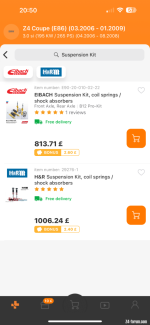

Thanks, the B12 kit is 4 X Bilstein shocks and a set of Eibach Pro springs… AUTODOC is one of the cheapest places to buy, via the App.

This is what you’re looking for, bit on the expensive side today… discounts varyR17SKO wrote: ↑Wed Jan 24, 2024 9:14 pmThank you for that.chanlon1 wrote: ↑Wed Jan 24, 2024 8:07 pm I’m building out my suspension using B4 shocks and eibach pro springs. Hoping the car will drop around 10-20mm
