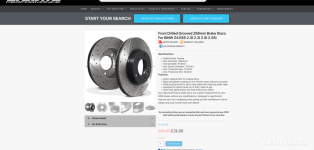

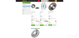

The front discs on my 2008 2.5 need to be replaced. Gravity Performance has discs for £75 grooved and drilled, the actual brand is unknown. Halfords has a selection, the Brembo discs for £62. The Gravity Performance from an aesthetic point look good but should I buy the branded Brembo ones? Any advice gratefully received
- Screenshot 2024-01-15 at 07-05-44 Car Brake Discs - Front & Rear Halfords UK.png (120.15 KiB) Viewed 539 times
- Screenshot 2024-01-15 at 07-03-36 Front Drilled Grooved 286mm Brake Discs For BMW Z4 E85 2.0I 2.2I 2.5I 2.5Si - Gravity Performance.png (194.92 KiB) Viewed 539 times
