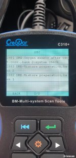

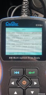

Hi , got the dreaded light on the dash today and plugged in my code reader and I got a bunch of codes.
The light came on the day I bought the car and basically the same group of codes have come back, this has taken approximately 3 months and roughly 800 miles.
No obvious issues to the running of the car and nothing untoward in the engine bay, no split hoses or anything disconnected.
Basically I need to know what to do next?
Replace the sensors showing faults?
Any ideas appreciated
See photos for codes

First of all you need to check for any leaks from the exhaust. Common on the downpipe joints.
Could just be a simple fix before you start throwing money on sensors

Which light did you get on?
EML?
The fact you reset and then it took that long to come back tiers in nicely with colb's description of what happens when you get an air leak.
The DME keeps richening the mixture as the unmetered air makes it think the engine is running too lean. Eventually it runs out of adjustment and the light comes on.
EML?

The yellow engine shaped warning light is the Engine Management Light (EML). Since you have fuel trim codes look for split or holed vacuum hoses/pipes and inlet boots. If you cant find any try a smoke test that should find ay leaks.

I got those codes and reset them. Lasted a while but kept coming back . Its the heater element in the sensor which it seems to fail intermitently . As the sensors are located right next to the troublesome exhaust joint it could be that is letting air in . Either way unless you are houdini and a glutten for punishment get a garage to fix it.

If its the heater circuit in the sensors thats gone bad then only option would be to replace them, only fit oem sensors such as Bosch, do not buy cheap or those universal types that have to be wired in. Once fitted run car up to temp, clear any codes with your scanner then take a look at live data on the exhaust sensors to see what they are doing, you should see a nice wave form in graph view as the sensor ranges up and down the voltage range (Pre Cat Sensors). Post Cat sensors will look quite static unless they are picking up bad exhaust gases.

From my limited research I think the sensors are at fault as I'm not getting the p code's which I think lean towards vacuum leaks etc
Plus the heater circuit faults are identified with the check engine light on.
Can anyone recommend a reputable supplier for these and confirm if both sensors are the same?
I've looked at realoem and I think they're the same but when I Internet search the part numbers and lengths etc vary considerably so I don't want to buy the wrong ones.
Also can I cause any damage if I drive the car with the lights reset?
