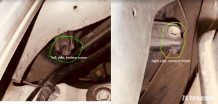

- Posts: 14
- Joined: Wed May 12, 2021 7:58 pm
Headlamp adjustment issues
Checking here, they do have part 63127165675, but I don't see any subparts: https://www.sytnerstevenagebmwparts.co. ... 65675.html
This image shows the left side where I broke the screw, and the right side with the screw intact (but hard to move).
I would appreciate it if anyone could recommend a seller where I can buy a used spare headlight or any suggestions on how to fix that broken screw.
Thanks
Thanks
