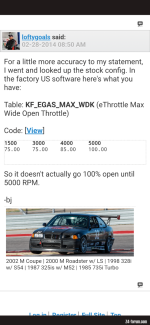

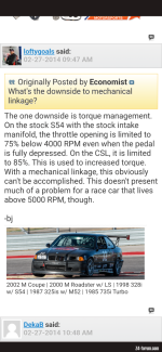

One thing I've noticed is that the throttle limiter on z4m is much less aggressive than what is said to be used in the e46 m3 and csl. The limiter in place on the m3 is supposedly to help with torque, but I wonder if the z4m limiter is in place to help with rod bearing wear. See attached pics, as well as below link for reference.
One of the items I was hoping to do with my tune was to at a minimum reach parity with what the csl has /allows, including changing the limiter (if not removing it altogether). Before I do so, I want to ensure that I mitigate any incremental risk in doing so. Or at least understand why these values would be different between the two platforms.

Limiting throttle on the S54 engine has *nothing* to do with rod bearing wear. Maximum cylinder pressures are around max torque values (about 5000rpm-ish on the S54?). Max cylinder pressures naturally have a big effect on bearing wear - big impact on piston translates into big impact onto rod bearing. Limiting the throttle openings has everything to do with air speed to maximise torque and driveability.
Thrashing from cold will have more effect on rod bearing wear than torque limiting or oil pump spec. Bearing clearances are pretty tight on the S54 to minimise parasitic losses but that also means maintaining bearing film thickness is a challenge when the engine is cold. I’ve said this several times - S54 bearings are a touch too narrow - accept they are a service item every 50k miles, warm the car through properly before using high RPM or throttle load and you’ll be golden.
Oil pumps on S54s are pretty basic - volume goes up (to a point) with revs until the relief valve kicks in. You’d be surprised how much flow there is at idle and low revs. You could try to have variable flow against revs, but likely you’ll cabbage the engine’s requirements somewhere on the speed / load range. BMW likely spent a LOT of R&D cash getting the oil system as well sorted as they could for the S54.
I’d leave the oil system well alone, get your bearings done, get your engine mapped properly by a reputable S54 expert and use a high quality oil changed at more regular intervals than BMW recommend.
