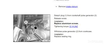

Can anyone tell me where it is and how to change it. Car coding at P 1396. Thanks This is on a 2008 2.5

Assuming it is the N52 engine, then it seems to be described as a 'pulse generator' and it sits below the starter motor.
Screenshot 2023-09-20 181839.png (137.97 KiB) Viewed 263 times
