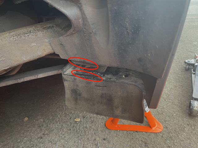

Once you have jacked the car up, put it on axle stands, chocked the wheels and given the car a good push to make sure it isn't going anywhere:
1. To remove this plastic cover, undo these three nuts
2. Going underneath the car, remove this nut. You should then be able to remove the cover in the first photo.
If you still can't remove the cover then check underneath, may be a plastic fastener which needs to be pushed (my one in this guide didn't have any, may have fallen out!)

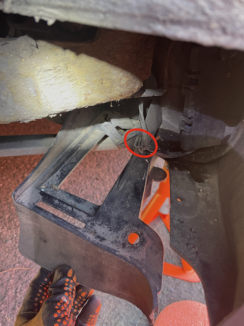

4. Unclip this wire from the plastic bracket before removing the bracket entirely

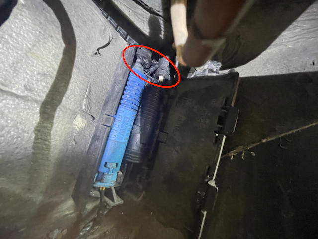

5. Open the plastic housing and locate these electrical connectors. Remove connectors from housing, being careful not to damage wires by sliding the tops out first as highlighted:
6. Connectors should then be loose

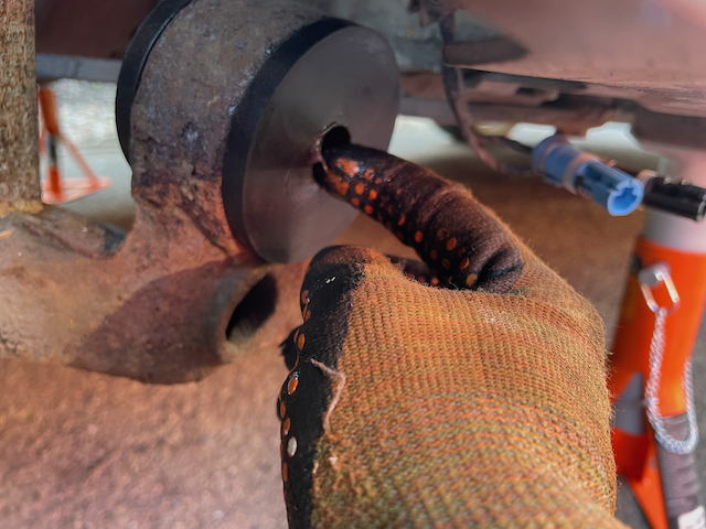

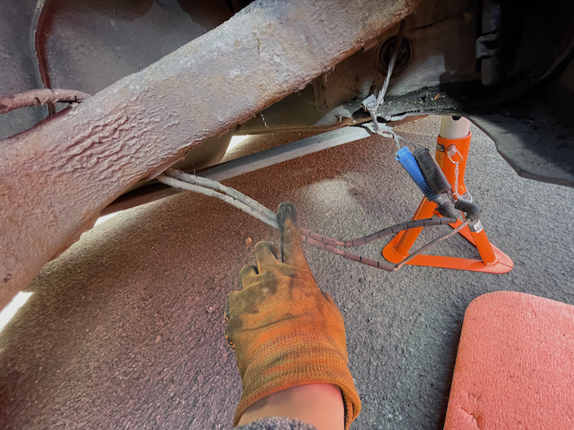

7. Getting under the car, pull these wires out of the plastic clips so they're slackened
8. Wires should be slackened like so

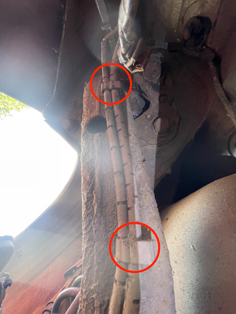

11. Unclip the wire from another plastic clip further along

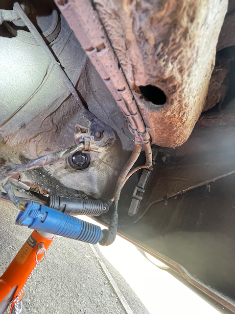

12. Getting behind brake discs, locate and undo this nut
13. Check these wires are slack, so that when you lower the rear trailing arm it won't pull any cables.

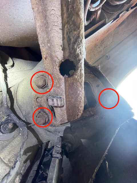

14. Locate these three nuts and mark their current position - this is to maintain current alignment as much as possible before you lower the rear trailing arm to get access to the bush, although alignment is definitely recommended anyway
15.Position jack ready for lowering the rear trailing arm
16. Undo the three nuts and slowly lower the trailing arm - note the wires which are loose so they aren't getting pulled when lowering the arm

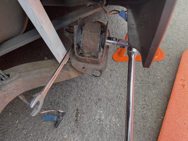

18. Loosen the nut holding the bushing carrier in place using a socket/wrench on each side. I had to use a breaker bar on mine!

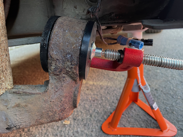

19. Once you've removed the carrier and left with the bush, prepare your bush removal tool

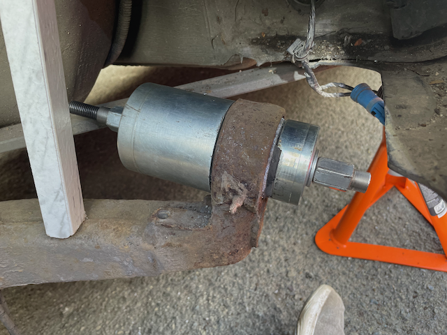

I used the spanner on the other end propped against the trailing arm to give me the resistance I needed to tighten the nut closest to me on the removal tool, I've tried to highlight the position of the spanner
20.Start tightening the tool and you should see the bush being pressed out. When done, loosen the tool and you'll be presented with your reward, the bush located inside the tool.
To remove, I used a socket extension to hammer out (be careful, don't get it stuck!)

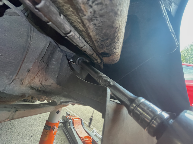

Use socket with universal joint adapter to tighten easier
