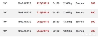

Hi,
Very likely to switch my wheels (17 inch 292 turbines) for either 313 or 326 19 inch wheels at some point - no rush.
If I see either advertised will they always be the same fitment?
i.e. a set of 313s will always be:
FRONT 8J - ET 37
REAR 9J- ET 39
Bonus questions:
- are both as prone to splitting?
- do RF tyres play a big part in the splitting? (I don't run RFs)
FRONT 8J - ET 37
REAR 9J- ET 39
Bonus questions:

326m has 29 and 42 mm offset so not the same..
Also they are 8J and 8.5J
326M are notorious for cracks ..not sure on the others..
Runflats have a major impact (pun) on cracking..although not exclusively

Thanks for reply B21.
So all 326m will ALWAYS be either ET29 or ET42 - there won't be a 326m with a different offset?
They are often listed without offset - just diameter and width. If I have width and the ET is always one of two ^ then I should be golden to assume they're good to fit.

All 326 and 313 wheels the same?
There is one and only one format for 326m
AFAIK only ever used on the E89 Z4

There are two 19” 313 options;
Alpina Roadster S Lux no. 204 (1 of 15 uk cars in Alpina Blue)

Would I be right in saying that all the 313s would be okay but the front 8j ET 37 would ideally have a ~8mm spacer?
The 39 Vs 40 for the 9j rears world make no odds I'm guessing?

5mm spacer would suffice depending on what tyres are fitted..nothing required on rearfatbaldboy wrote: ↑Sat Apr 29, 2023 10:15 am Would I be right in saying that all the 313s would be okay but the front 8j ET 37 would ideally have a ~8mm spacer?
