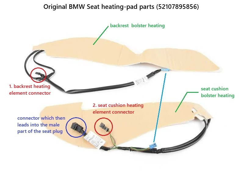

The car had non heated M Sport seats which I've refurbished and fitted generic heating pads from eBay to. As they aren't selling I thought what the hell lets pop them back in the car and see if we can wire them up properly.
If fitting factory heat pad seats then there will be additional steps to cut the loom in but the principles will remain the same.

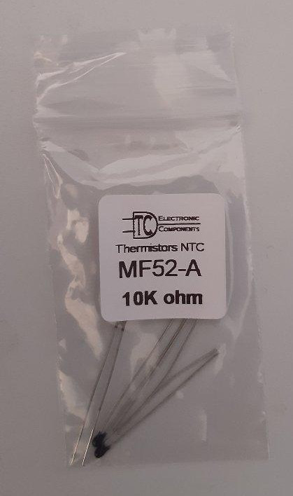

From eBay some 10k thermistors
