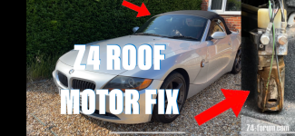

Hello all,
My Z4 suffered from the common fault with a corroded roof motor from the housing filling up with water.
Usually a garage will remove the entire roof to get access to the motor costing a lot in labour time, instead I found I could access the motor from the boot which will save you money.
I hope this video helps show how you can do this yourself, I’ve seen a lot of videos that are quite vague so hopefully this will give you a clear and concise guide of how to do it.
https://youtu.be/NPhwOO654JA
Soft top motor fix and relocation without removing the roof

- D7807862-E808-4388-BA24-ACF178886C4F.png (941.27 KiB) Viewed 1551 times

That's a great video Ashley - a lot of people will find it very useful!
