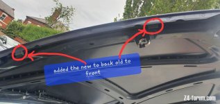

I have these on mine - they are not held on tightly and slide up and down easily so you need to be careful you don’t knock them off when cleaning.
Some pics :
Some pics :
- C25E0F71-C30D-459E-9F8B-B60E381C9381.jpeg (257.04 KiB) Viewed 2160 times
- 9E74BA8B-3AAB-4824-A628-DFB419188B63.jpeg (222.15 KiB) Viewed 2160 times
- B28E33EF-478A-446F-B6F9-392CED3E3563.jpeg (214.93 KiB) Viewed 2160 times

Thanks Bing, just what I was after. I would imagine like you say they've been knocked off at some point and not noticed / bothered to replace, but hopefully they'll cure the rattle.....

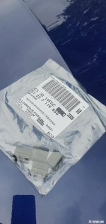

Well the £8(!) tiny bits of rubber fixed my rattle, now nice and quiet. Those buffer stops were also broken as you suggested, springs missing on both sides when i took them out so ordered 2 of those as well, cheers!wyshyvanuk wrote: ↑Wed Jul 08, 2020 8:05 pm Also, please see:
Buffer stop with ejector Part# 51248187291
Two under the bonnet and two under the boot.
