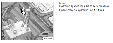

i. Release the hydraulic pressure on your hydraulic pump turning it only 0.5 turns (or a little bit more if you believe it's really hard to manually move the roof later on). Reffer to the image below taken from the newtis manual in order to find the right "screw" on the pump. Only do 0.5 turns, about a year ago somebody did 1.5 turns on my pump and I got left with a leaky pump and had to do another sh*t ton of stuff in order to fix it.

ii. Release the hydraulic pressure on your hydraulic pump turning it only 0.5 turns (or a little bit more if you believe it's really hard to manually move the roof later on). Reffer to the image below taken from the newtis manual in order to find the right "screw" on the pump. Only do 0.5 turns, about a year ago somebody did 1.5 turns on my pump and I got left with a leaky pump and had to do another sh*t ton of stuff in order to fix it.
![Image](https://i.imgur.com/w3OeoDX.png)

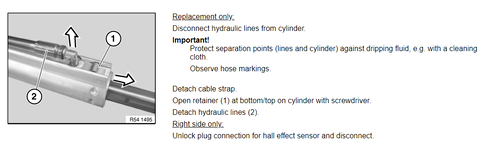

How do I remove a hydraulic line from a cylinder?
As you might have seen in the hydraulic lines kit you received new safety "pins" for the hydraulic lines, so, refer to the picture below that shows you how to remove a hydraulic lines from a cylinder and remember that you need to replace the safety pin on it after.
![Image](https://i.imgur.com/IPCSKrC.png)
It's also nice to remember that hydraulic lines contain hydraulic fluid which is pretty much oil that will leak in your car if you do not use a cloth to tape the ends down from the hydraluc lines that you disconnected.

3. Put the pump back into it's place and remember to fasten the screw that released the hydraulic pressure. Put the trunk partition panel back. Put some hydraulic oil into the pump (if you see it's below MAX). Go inside the car, start "opening" or "closing" the roof. You will hear the pump hissing, it's taking out the air from your hydraulic system. After it does that for like 4-5 seconds, go back in the trunk and check the hydraulic oil level, then add more if needed.

4. Remove the hydraulic pressure (you already know how). Put back the rear roof shell using the new screws and align it. There should be a 4.0mm gap between the front and the rear shell. In order to achieve this. Fasten the first two bolts on both sides from the top part of the rear roof shell, then let the roof go down on it's own, I used an 4mm drill head to achieve the "desired gap". Then fasten the bolts from inside the car. After that, fasten the screw from the hydraulic pressure, then get the rear roof shell into "working position", fasten the last 2 bolts (one on each side). Then let the roof go down on it's own (by removing the key from the key fob) and check for alignment, if it's ok, then you are done.
