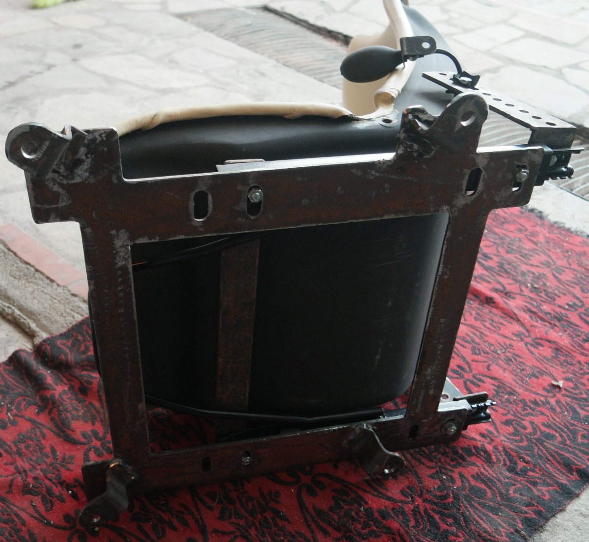

1. in the first photo you can actually see my miata, getting jealous
2. fwiw, I didn't have any issues on the dashboard after connecting the battery and going for a small drive for testing purposes
3. ignore;
a. the fasteners, being smaller than the ones that will finally be used
b. the steel which will be sandblasted and painted accordingly
c. the wrong seat being used for all the testings
d. the (as, you lot, will mention) wrong side of the steering wheel.

good job fella.
i'd love to find some beige sports seats too but heyre like hens teeth
is that a side-bolster pump bladder in pic 3? the black rubber oval thing?
or is that your winky-woo enlargement device hooked up for those opportune moments spent in traffic jams?

Yes, most Lotus Elise seats seem to have that lumbar support pump..
but can be used in many ways..

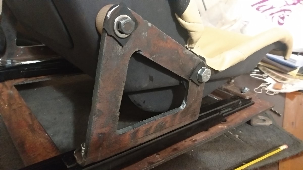

final touch, the belt tensioner;
a small pin was welded to the inner side bracket in order to help keep the belt tensioner in place.
Was later chopped off though because it protruded a bit.
Drove the car for about 2 hours and absolutely no squeaks whatsover.
more pics to come of the final product.
