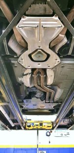

Here's mine it's plug and play
- 20170705_181529.jpg (165.38 KiB) Viewed 1633 times

D4dawg - thanks for the pic, fab. So do you have just the catless section 1 fitted which it looks like, you don't have the SS section 2 right?

Dawg has the oem x pipe the same as me, the supersprint one has the sliding joints on it.
