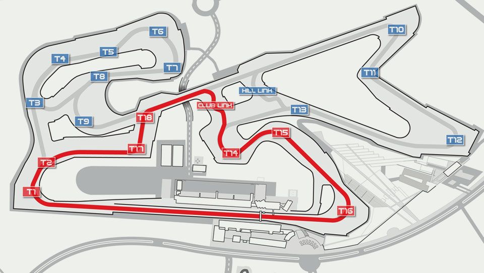

Pretty much the only reason i got these is as Turn 1 on my local club track is a very high speed straight into downhill right hander, and my last session, i saw one of the meet cars pretty much brake fade and just missed the wall at some very impressive and shorts staining speeds.
