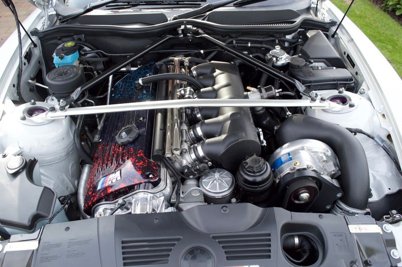

i use worm clamps here...
they need careful alignment but work well..... you can just see the lead clamps on the front TB and their position. They hold pressure well, and i haven't Re-Tq'd in a year, still holding 8.5lbs of boost...
