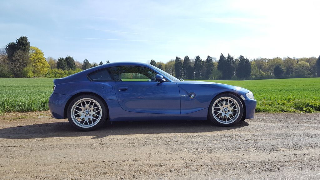

After lots of faffing about I had my new wheels fitted today. I thought I'd stick down some details that may answer questions that people may have when swapping wheels (should add these were the questions I had and I got all my answers off the great people on here, especially mr wilks and SimonUK):
* New wheels are Riva DTM 18"
* Front wheels are 18 x 8 ET34
* Front tyres are Michelin Pilot Sport 4 225/40 18" (not run flats!)
* Rear wheels are 18 x 8.5 ET37
* Rear tyres are Michelin Pilot Sport 4 255/35 18" (not run flats!)
* Car is on eibach springs
* Original wheel bolts were reused
* Center caps were from amazon and are the normal 68mm size
* The space for the little M badge/sticker on these wheels is bigger than standard (hence not on my wheels yet as trying to find bigger versions)
Before:
After (immediately after so springs should settle a bit):

Looking good. Are those offsets good I.e. no rubbing?

Looks good. Never seen bigger wheel badges though. Always seems to be a slight gap around them.

Looking good , looks like 19s with the ride of 18s :thumbsup:

No rubbing so far and I know others on here run the same offsets without issues.

I did wonder if that was the case or if I'd find them on a big X5/X6 wheel

Sorry to ressurect and old Thread, but I am also considering getting the DTM CSL's also but was worried they wouldn't look great in a 18".. But on yours with the Eibachs they look Schweeeet. Which Eibach set did you go for? Was it the b12 set?
