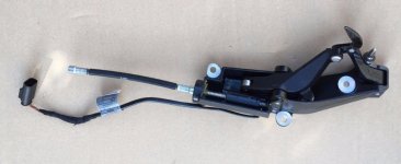

Has anyone gotten the code "CVM: Drive, cowl panel, current too high when opening safety catch" Not sure what this means?? :o

Post by ph001 » Thu Jun 13, 2019 11:53 am
Maybe the motors that drive the catches in the front cowl taking to much current due to the mechanism being jammed / dry?? I'd get in there by removing the cowl at the front of the roof everything a good spray with GT40. It's also very important to keep the release catches greased.... If not that, then probably broken wires as per above, shorting out on something.
roof latch 2.jpg (115.31 KiB) Viewed 5366 times
roof latch 3.jpg (89.4 KiB) Viewed 5366 times
