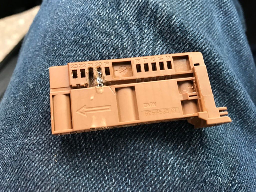

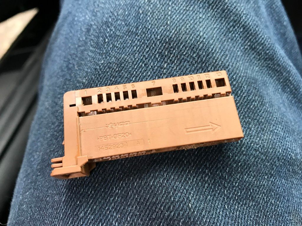

Does anyone know the part number for this plug? It's the one that goes into the roof/heated seats/traction control buttons. I've tried the number on it with no luck. Can't find it on realoem either.
As you can see, mine is a little broken, with 2 pins stuck......

Part number printed on the plug, look at your first photo.

Looks more melted than broken

Marius wrote:Part number printed on the plug, look at your first photo.
Did you bother to read the bit where he said the number doesn't work in RealOEM???
Thought not.
OP,
Have you looked here:
http://www.realoem.com/bmw/enUS/showpar ... Id=61_1280

its refered to in some manuals as bmw x1869 connector
If you can find a heated seat fitting kit looks to be on that
http://www.ebay.co.uk/itm/BMW-E46-Origi ... -07ETLCkBg
that looks like it has it, scrappers maybe yer best bet

Its definitely broken, as I broke it trying to get a stuck pin outDMC63 wrote: Looks more melted than broken
VRSteve wrote:Did you bother to read the bit where he said the number doesn't work in RealOEM???Marius wrote:Part number printed on the plug, look at your first photo.
Thought not.
OP,
I have looked at that section. It looks a little like item 9, but its not available as a 23 pin plug.
I've tried all the numbers stamped into the plug and nothing is coming up for either in realOEM or google.
I've emailed a few breakers to see if they can supply the part.....as its the same plug on every z4 there must be one out there somewhere!biojo wrote: its refered to in some manuals as bmw x1869 connector

Hurrah. I've found it.
http://www.realoem.com/bmw/enUS/showpar ... Id=61_2116
Its listed as a X5 part!
