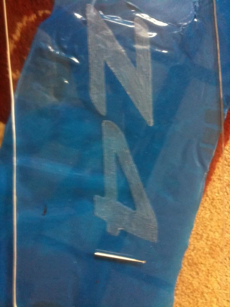

put the frame back together then made a template from cardboard. then used the template to mark out the shape onto the plexiglass. i used the 561 piece with the multipurpose cutting tool to cut out the plexiglass which only took a few minutes.
step 5:
sanding took me hours as i left a bit too much 'room for error' but you can never put material back as i found when cutting one of the grooves to fit around the spring holder.
step 6:
i got the Z4 logo off of the internet and printed it off at 6cm high which i thought was enough. i then turned the paper over and drew the outline to get a negative to transfer to the pexiglass. etch on the side that will be facing the front of the car as the light looks better for the people behind this way. i stuck it onto the back then went around the design with a pen then used the dremel to etch the outline using 107, i then went ahead and shaded the entire thing in which only took 10 minutes. best to have some practice with this tool first though. ( i wanted to have it sand blasted but its hard work finding somewhere with the right equipment but the results i got where great)

thats really cool... let us know what its like while driving...
also for future projects, they sell a glass etching paste at graft stores, just make a paper stencil then paint it in... wipe off in ten minutes and you have yourself etched glass, i think it would work on plexii also.

spr_bimmer wrote:thats really cool... let us know what its like while driving...
i was reading about the pastes but some people said it didnt work so well on acrylic
