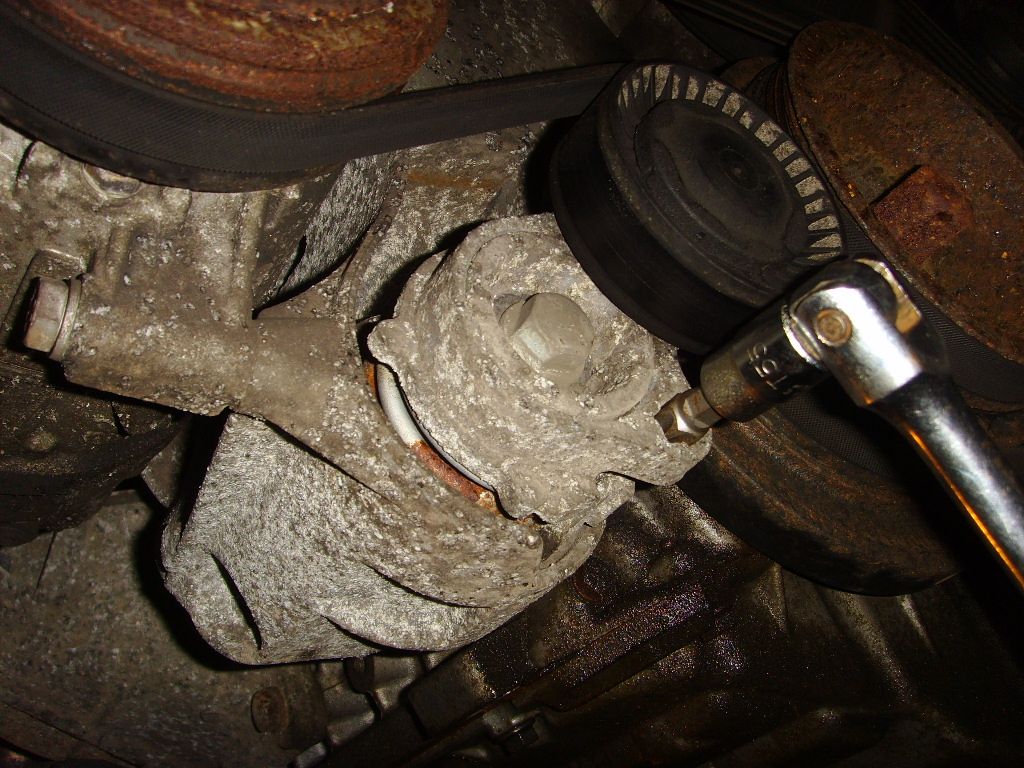

Remove Air Con Belt using a T55 male spline on tensioner. Its spring loaded and needs a small amount of force to move the tensioner idler (see photo)

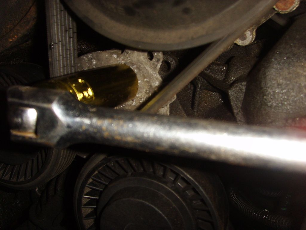

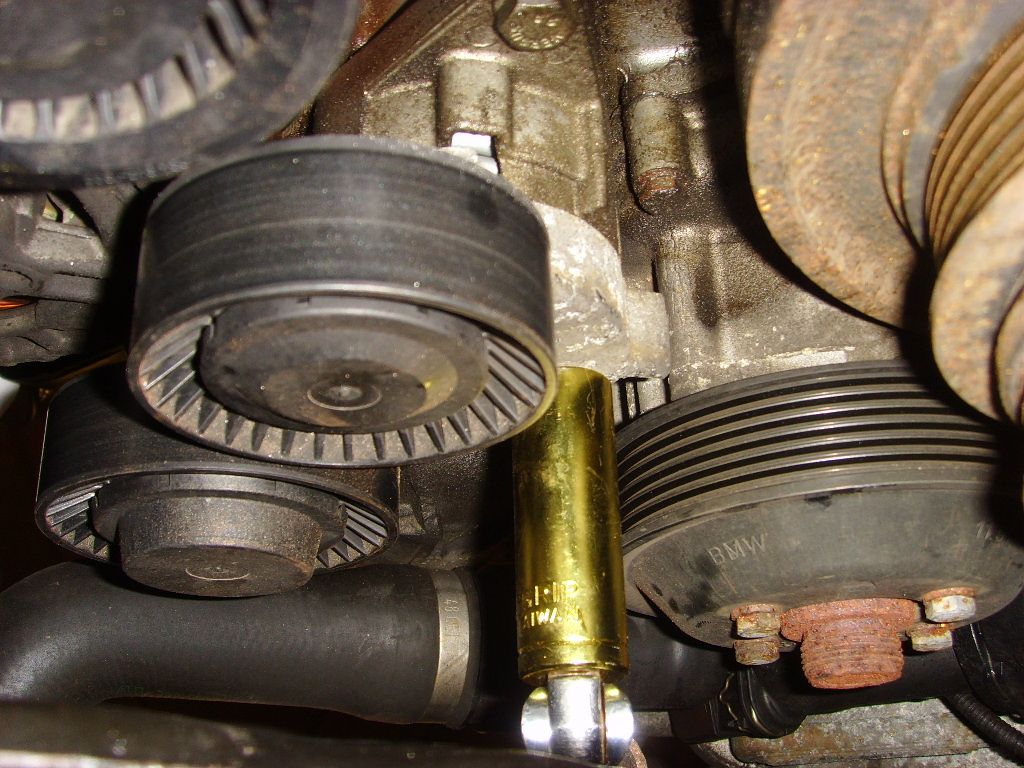

The tensioner pulley is fairly difficult to access as it is mid way up the front of the engine. You need a 16mm socket. I used a deep socket hex type not multi hex as the tensioner is quite hard to move and its easy to slip. Tensioner releases in an clockwise direction. (looking at front of car) Ease the belt off when tension is released.
Second picture is with the belt removed and is from beneath the engine (alternator on the LHS of the picture)
