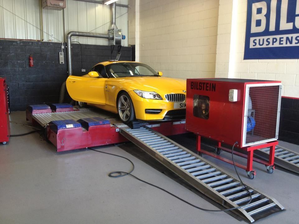

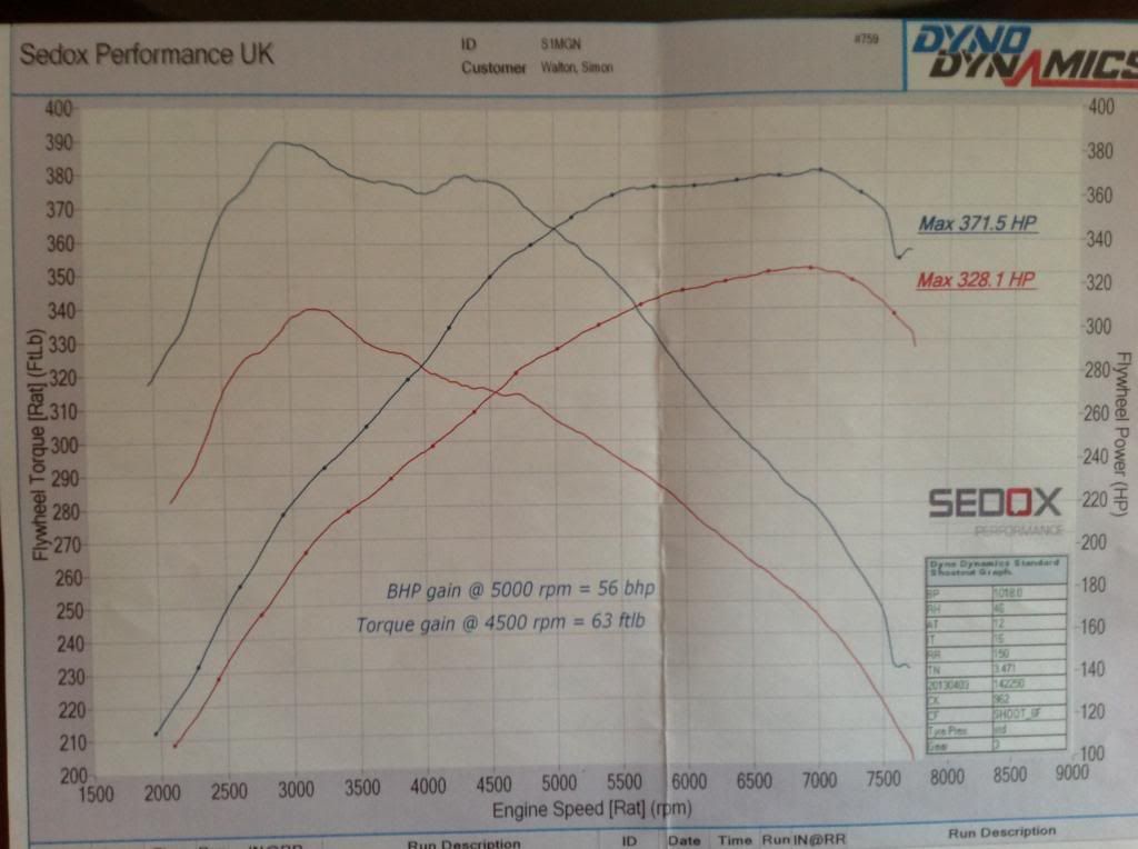

Pleased with the results from SEDOX in Sunderland :)
Power and torque is there a lot longer in the range.
371.5HP which is nearly 380PS :evil:
The ESS tune is a download. I've always found it better to start with a download and then some fine tuning to the exact engine staying within all the safe parameters.
0-60 will not improve until I change the dif and tyres as the 35is can't successfully put the power down successfully. I have tried the launch control a few times on difference surfaces and found you can pull away quicker without it.
Above 40mph the difference is unbelievable.
It's not something you install yourself.
