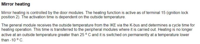

One interesting snippet I came across whilst studying the wiring diagrams on TIS earlier, is that whereas we all thought the mirror heaters are always on, they aren't;
It's just that it never gets above 25 degrees in the UK - However, what a stupid temperature to set as the cutoff?
Mike
